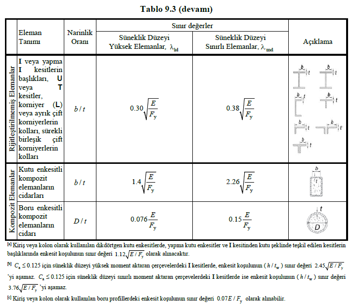

### &#x20;Tablo 9.3
<div data-with-frame="true"><figure><img src="https://564595168-files.gitbook.io/~/files/v0/b/gitbook-x-prod.appspot.com/o/spaces%2FgyS5HogmYUWhqldYClsz%2Fuploads%2FyERKfDaPHrc49r0A3yVQ%2Fimage.png?alt=media&amp;token=dea032ce-5e80-4e81-91ac-198a24693c36" alt=""><figcaption></figcaption></figure></div>
<div data-with-frame="true"><figure><img src="https://564595168-files.gitbook.io/~/files/v0/b/gitbook-x-prod.appspot.com/o/spaces%2FgyS5HogmYUWhqldYClsz%2Fuploads%2Fz7p2rq55FnqQQiQtEfOF%2Fimage.png?alt=media&amp;token=28db0d51-3ab1-42f6-8c73-0026455bdb27" alt=""><figcaption></figcaption></figure></div>
